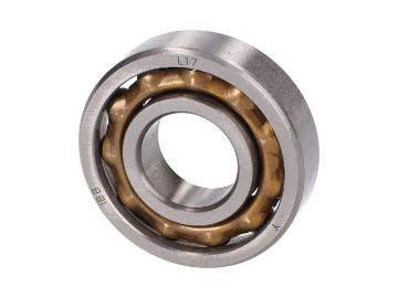

Top Racing crankshaft suitable for Sachs or Hercules 50/3 or 50/4 (L17 bearing), Sachs 3- and 4-speed engines.Difference to Sachs 50/2 crankshaft with part no. 44012: cheek pin diameter is larger (L17 bearing must be used).Technical data: Ignition-side cheek pin overall length: 70.6mm Ignition-side cheek pin diameter: 17mm Clutch-side cheek pin overall length: 43mm 1st shoulder - cheek pin on clutch side - diameter: 17mm 2nd shoulder - cheek pin on clutch side - diameter: 12mm Thread on both sides: M10x1mm Suitable for 12mm gudgeon pin.
